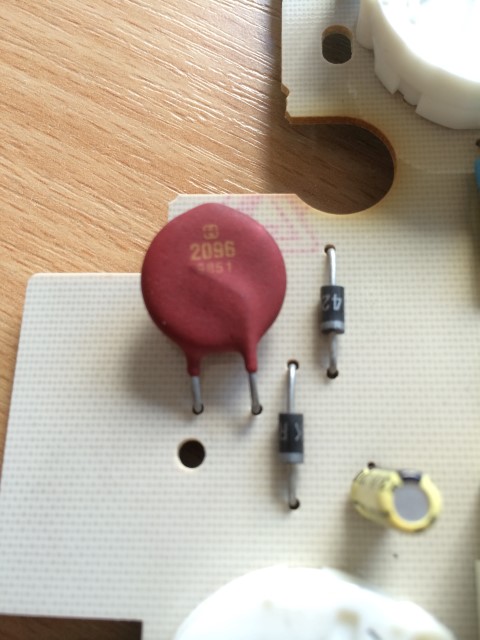

I have a ceramic cap I need to replace and the markings on it are not conventional.
Instead of the normal numbering scheme it has 2096 and below 9851
I can't seem to match this to any known value, does anyone have any idea?

It could be a varistor.
Can you upload more pics of the PCB front and back? What is it for?

9851 may well be a manufacturing date code.

Nothing on the back of it. Not sure what it's purpose is.
It's on the PCB of an instrument cluster for a Vauxhall. The chap in Maplin said he doesn't think its a capacitor at all...
Now that you mention Varistor, a quick google shows this up as a Harris Varistor, although I cannot seem to find out what values it has to select a replacement.

Can you put pics up of both sides of the PCB?
It may be a long shot but have you tried contacting Harris?

Vauxhall what... and what year.
It may be easier to get a new board...
Put ''breaking vauxhall X'', with out the word vauxhall, in an ebay search.
